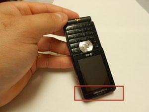

Flip the phone over and remove the Sony Ericsson sticker that is over the phone's ear speaker.
Using a T5 screwdriver, loosen and remove the two screws under the Sony Ericsson sticker by turning them counterclockwise.
