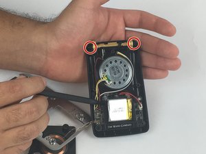

Use the spudger to lift the battery.
Be careful not to lose the sensors located on the hinges of the antenna grill. If removed from their location, put them gently back into place.
