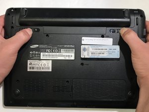

Locate both the battery locking latches on the lower right and left sides of the battery.
Slide both locking latches outwards simultaneously to unlock the battery.
While holding the locking latches in the outward position, pull the battery off and set it off to the side.
Release the locking latches after completely removing the battery.
