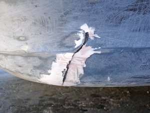

Repairing 1998-2002 Honda Accord Body Work - Bumper
crwdns2936025:01crwdne2936025:0 —
Use low-grit sand paper to sand off burs, debris and previous repair attempts so that the bumper piece can be manipulated back to its original shape.
Clean off all sanding dust when you are done using water and if necessary, soap. Clean the area around the crack on the inside of the bumper especially well, as this is where the fiberglass will be laid.
