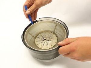

To remove the filter basket from the surrounding bowl, use a plastic opening tool to create separation between the basket and the bowl.
Once there is enough room, place your fingers under the grooves of the filter basket and lift up.
