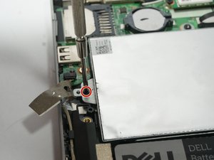

Pull back the sticker covering the first screw on the hard drive chaises.
Useing a Philips Head #0 screwdriver remove the three screws holding the drive in place.
