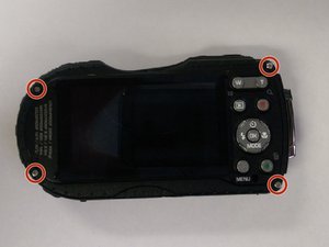

Using a Philips head screwdriver, remove the 6, 5 mm screws, 4 on each corner and 2 on the sides of the device.
One of the side screws is hidden under the top lining of the device.The lining is glued down to the device, you will have to peel the lining back using tweezers. After you are finished with your work you will have to use glue or adhesive to re-stick the lining back to the device.
