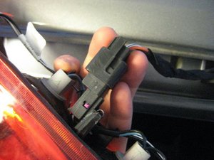

Replace with the LED bulb.
Test your new LED truck high mount brake lamps to make sure everything works.
If the LED lights don't light up, check the polarity by flipping the bulbs 180 degrees.
