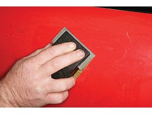

Block sand the panel with 2000-grit wet/dry sandpaper and plenty of water. Sand until the shoe polish disappears.
