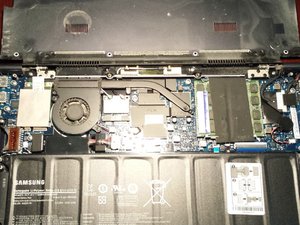

Step 2: Once it is open, you'll be happy to see that there is nothing obstructing your access to the battery. You should clearly be able to see the screws to remove the battery, and the cable attached to the motherboard. Once you've removed the screws, simply jiggle the cord until it pops out.
