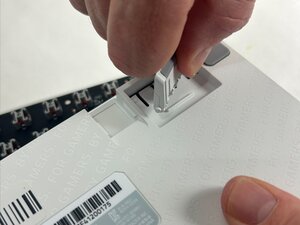

The base model has clips on both sides of the legs securing it in place.
Carefully lift and slide out the broken leg.
If the leg is stuck use a plastic pry tool around the edges to loosen it.
Avoid using excessive force to prevent damaging nearby parts.
