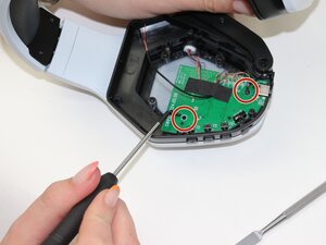

Highlighted are the screws needed to be removed from the circuit board
Use Phillips #0 to unscrew
Remove the motherboard from the headset.
