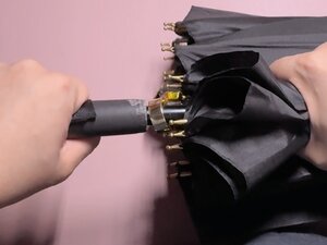

If the handle is glued, twist and pull gently to remove it.
If it’s difficult to remove, apply heat with a hairdryer to soften the adhesive.
