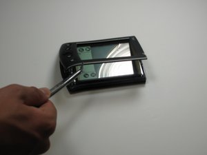

Now pry open front and back casing with plastic opening tools.
Separate front and back casing completely.
Power button will fall off once front and back casing have been removed. Be sure not to lose it.
