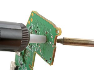

Secure the motherboard so you can access both sides of it.
Use the soldering iron to heat one side of a through-hole.
Use a desoldering pump on the opposite side of the through-hole to suck up any remaining solder.
Don't heat the through-hole continuously for longer than 15 seconds at a time to avoid damaging the pad.
If needed, use solder wick to remove any residual solder.
Repeat this for all through-holes and both sides of the motherboard.
