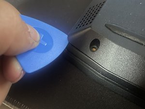

Using an openning pick or just any credit card or something like it try to open get an openning. In this case going at an almost 45º angle on the corners or the back side proved the easiest for me.
The first time you open the laptop may be harder and you may need to try it a few times. But don't give up and be gentle!
After you have an openning using another openning pick or the same slide along the borders until the back pannel is loose and then remove it
