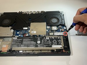

Remove the single 4.1 mm Philips #00 screw holding the SSD in place.
Pull the SSD out and away from the socket.
