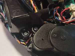

Ensure that no wires have become trapped under the front of the housing. The area highlighted in red shows that the white/green/blue wire is pinched.
The next image shows that the pinch has been resolved, and a beautifully aligned reed switch.
