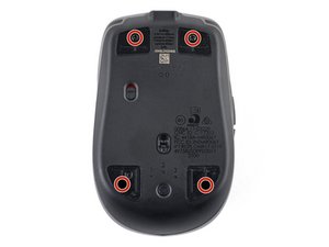

Use a Phillips screwdriver to remove the four 5.9 mm-long screws securing the lower case to the upper shell.
