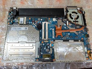

Unscrew the heatsink and fan assembly.
Disconnect the fan, display and power connectors.
You can open the fan itself to clean it further.
Clean the old thermal paste from the heatsink and replace the pad if necessary. Be sure to use the same thinkness pad.
