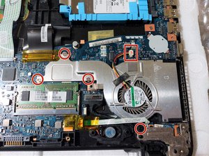

Unscrew the 4 screws holding the CPU heatsink and fan assembly and lift it up, gently.
Disconnect the fan.
Replace the thermal pad. Be sure to use the same thickness thermal pad.
