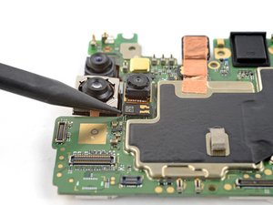

Use the pointed end of a spudger to pry up and disconnect the macro camera's press connector.
There's no adhesive securing the camera to the motherboard. Be careful disconnecting the press connector, as it may eject the camera.
Use tweezers or your fingers to remove the camera.
