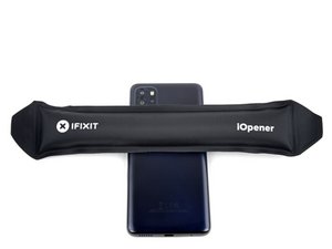

Flip your phone over and apply a heated iOpener to the fingerprint sensor on the back cover for two minutes.
