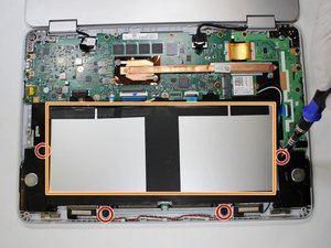

Remove the four 2.54 mm black screws connected to the battery and the speakers.
Take the battery out of the laptop
