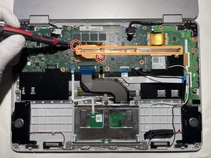

With the Phillips #00 Screwdriver, remove the two highlighted 1 mm screws attaching the heatsink (highlighted in orange) to the motherboard.
Then, remove the heatsink from the motherboard.
