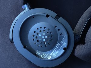

How to dislodge or realign stuck volume dial/slider of an Arctis 7+
crwdns2936025:03crwdne2936025:0 —
With the cup off, now you need a Torx TR6 bit to remove three screws. This is relatively easy, but do be careful when removing the lid, as there is a wire connecting it to the pcb housed in the body.
