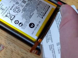

Carefully pry out the battery using a credit card or opening cards, taking care not to bend the battery.
The battery is held down with a ton of adhesive and removing it may take some time. Take your time and work at it.
