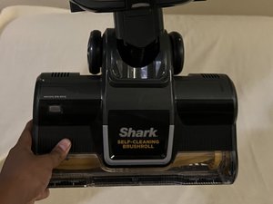

Push down on the bottom of the vacuum so it can dangle.
Using a flathead screwdriver to turn the lock counterclockwise, then open the cover to access the brush roll.
