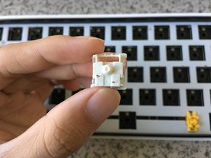

Do not bend or hold by the golden pins.
Match the key switch with the keyholes.
Align the two golden pins with the two tiny holes located by the bottom.
Push down.
You will hear a loud clicking noise when the key switch has locked in place.
