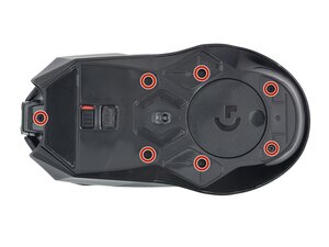

Use a Phillips screwdriver to remove the seven 4.5 mm screws securing the two halves of the mouse together.
On older models, the top middle screw may be a Torx T5.
