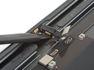

Insert an opening pick or a halberd spudger underneath the lower microphone and peel it up from the rear case.
