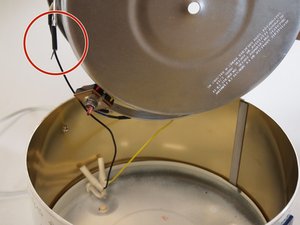

Remove the metal heating ring that is flush against the grey bowl by stretching the tight black spring near the potentiometer.
You might need the pliers again!
With the help of a friend, you will be able to maneuver and force the ring up and away from the bowl by also gently bending the metal to pry it off.
