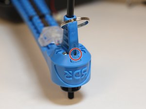

On the leg that the motor is attached to, remove the 8mm screw that holds the long leg foot in place using the 1.5 mm Hex screwdriver/key.
