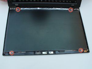

Remove the four 3.0 mm screws in the four corners of the screen with a Phillips #1 screwdriver bit.
While removing the screws, pry the screen off with an opening tool.
