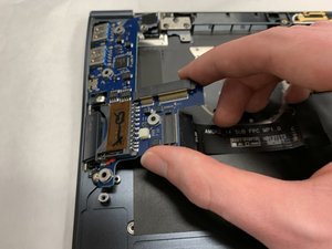

The I/O PCB is adhered to the frame.
Use an opening tool or spudger to carefully pry up the right edge of the I/O PCB.
Pull the board to the right and remove it.
You may need to wiggle the board to loosen the adhesive holding it in place.
