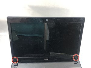

Pop the two circle screw caps off and remove the two screws using a Phillips #0 screwdriver.
Remove the computer's frame.
