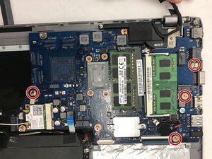

Samsung NP510R5E-A01UB Motherboard Replacement
crwdns2936025:02crwdne2936025:0 —
Use the Phillips #0 screwdriver to remove the four 3.0mm screws.
