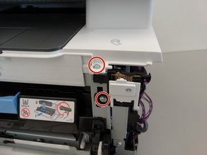

Remove two Phillips #2 8mm screws.
Unplug the wire connecting the power button to the circuit board by gently pulling them apart.
