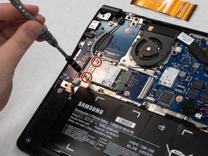

Using a Phillips #0, remove the two 3mm screws holding the hard drive in place.
Remove the hard drive by pulling it out with your hands.
