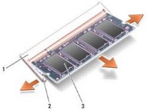

Slide the NEW module firmly into the slot at a 45-degree angle, and rotate the module down until it clicks into place. If the module does not click into place, remove the module and reinstall it.
NOTE: If the memory module is not installed properly, the computer may not boot.
