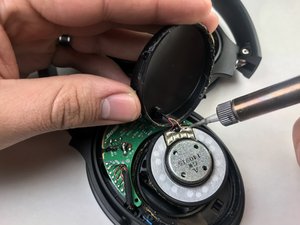

Remove all soldered connections that are connecting the existing speaker to the headphone. For help with this step see this guide on How To Solder and Desolder Connections
The existing speaker should now be free to remove and replace.
