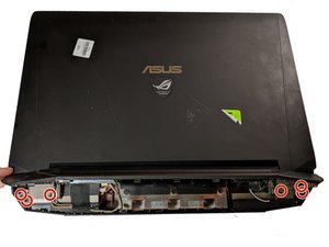

Unscrew the 6.8mm screws holding the hinges of the screen to the bottom half of the computer.
Detach the screen from the hinges of the laptop.
Be careful not to damage the connecting wires when detaching the screen.
