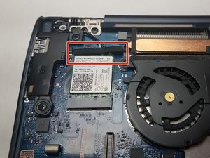

Remove the piece of foam that covers two antenna cable connectors.
Use the tip of a spudger or a fingernail to pry straight up and disconnect the antenna cable connectors.
