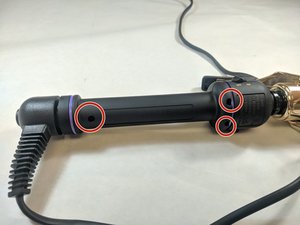

With the ring loose, turn the handle body over, and you will see three screw holes.
Take a PH1 screwdriver, and loosen up all three 6mm Phillips #1 screws in the handle body.
