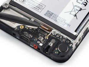

+[title] Disconnect the display cable
+[* black] Use a spudger to disconnect the display cable by prying the connector straight up from its socket.
