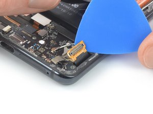

+[title] Free the display cable
+[* icon_note] The display cable is adhered onto the midframe by mild adhesive.
+[* black] Carefully slide the tip of an opening pick underneath the display flex connector to separate it from the midframe.
