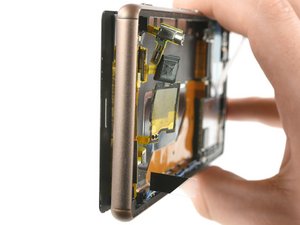

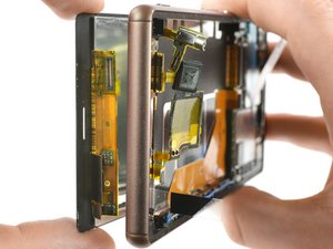

+[* black] To fully remove the display off your phone, you need to thread the display flex cable through the gap of the mid frame in the bottom end of your phone.
+ [* icon_caution] Take care of all the connectors of the main flex cable hanging around and of course the display flex cable itself.
