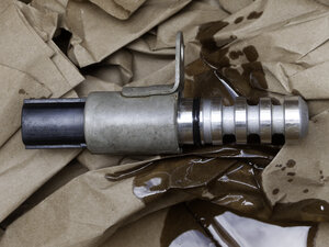

This Guide is based on replacing the exhaust camshaft control solenoid, specifically the uppermost of the three. ***ODBII Code is P0014.***
Symptoms are the car shaking like it's about to stall and the revs bouncing around at idle. The check engine light will come on after this occurs. You will probably have had to rev the engine to get the engine to idle steadily.
When you scan your car (or have it scanned) with an ODBII reader you will get a code of P0014. Below is the reading from our Rogue:
