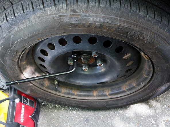

    • Before you raise the car, loosen the lug nuts on both wheels so you can check your brake wear whilst you have the car up on stands. If you know your brakes are new and good, just loosen the Passenger side (US) wheel lugs. On steel wheels, the lugs were too tight to remove with the Nissan wrench, I used a breaker bar and 21mm Socket!

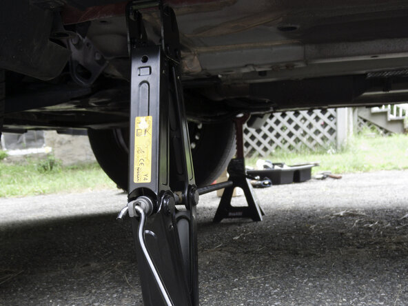

    • Jack up the front of the car and support it on a pair of axle stands. There are no obvious axle stand points. Find a couple of structurally sound points to place the stands. I'd put chocks under the back of the rear wheels. When I parked, I placed the car in Neutral to ensure it was on level ground. Once on the stands, put the parking brake on!

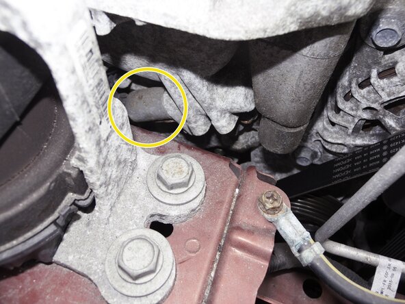

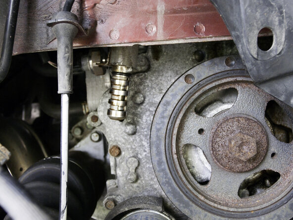

    • Removing the Exhaust valve timing control solenoid valve. Many YouTube videos will say to jack up the engine and remove the engine mount. You do not need to do this; the part can be replaced from below. The first photograph shows the solenoid's position viewed from above. As you can see, the engine mount blocks access to it from above.

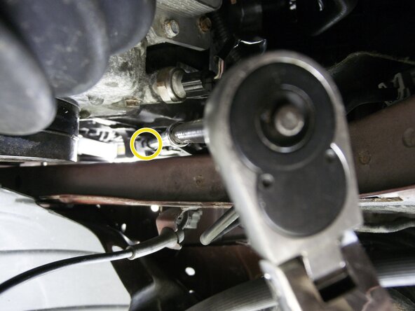

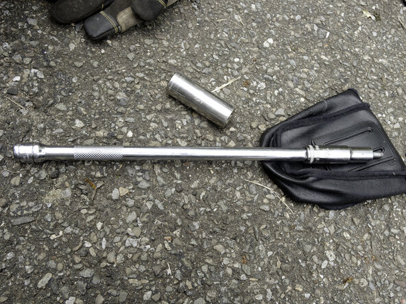

    • Using around 16 inches of extension bars and a 10mm socket, I used a deep socket. Lie under the wheel arch and reach up to the single retaining bolt. Unscrew it and carefully retract your extensions so as not to drop the bolt.
    • The final photograph shows the longest of the two extenders with a 10mm deep socket, and the retaining bolt still in the socket!

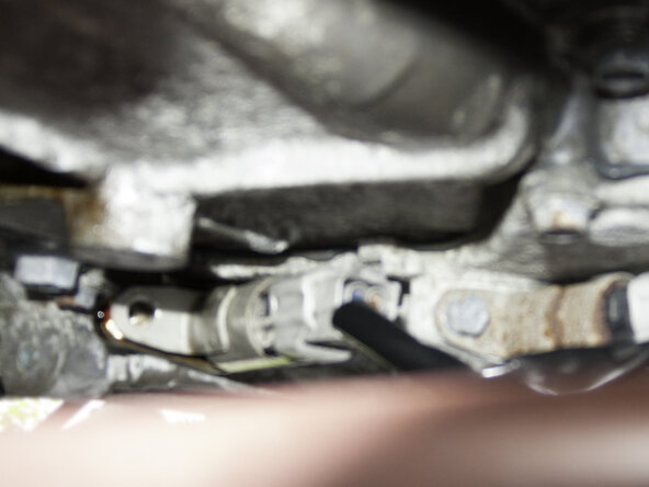

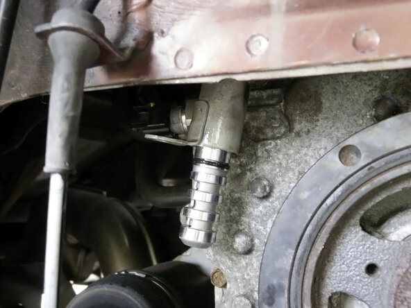

    • The first photo shows the Solenoid being removed from the engine. You can use a flat-blade screwdriver to get it started, then pull it all the way out and let it drop so you can unplug it. To unplug the solenoid, squeeze the Tab on the plug. I used Long-Nose Locking Pliers to depress the Tab and hold the plug while pulling off the solenoid.

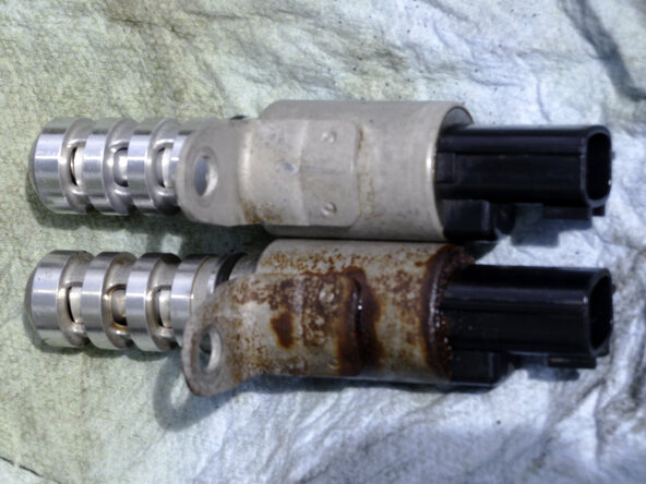

    • The last photograph shows the bad Solenoid on the bottom covered in rust, and you can see that the back by the connector is heavily corroded. Rust probably formed on the Armature, causing the Solenoid to stick open or closed. Above is the replacement used OEM part. The car it came from was not from the rust belt and is in perfect condition.

    • To replace the solenoid, connect it to the wiring harness, then you are going to lie on your back under the wheel arch so you can see the hole it goes in. Holding the body, you reach up with it, and very carefully locate in its hole and push it in! Leave it out a little, the distance between the o-ring and the body.
    • You can now use your extensions to place the screw through the Solenoid's mounting hole, align it with the hole in the engine and slowly screw it tight!

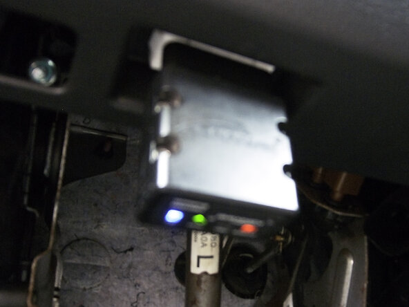

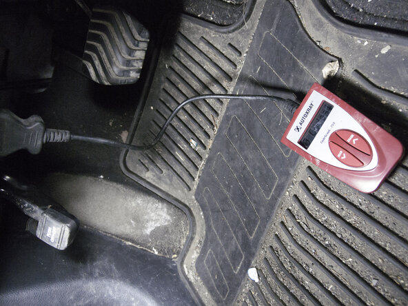

    • Once the solenoid has been successfully replaced. Plug in your chosen OBDII tool into the port located below the steering column and slightly to the left. (See photos). Turn the key to accessory and use your tool to clear the code!
    • Once you have cleared the code, start the engine to make sure the new part is good. Turn off your engine.
