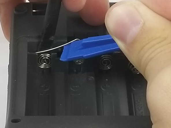

    • With the flat end of the black plastic spudger, pry the terminal away from the case.
    • Use the small blue plastic opening tool to lift the terminal out of the device. Repeat for the adjacent terminal.
    • When lifting the terminal out, the metal wire of the terminal must move past the plastic protrusion that keeps the battery terminal in place.

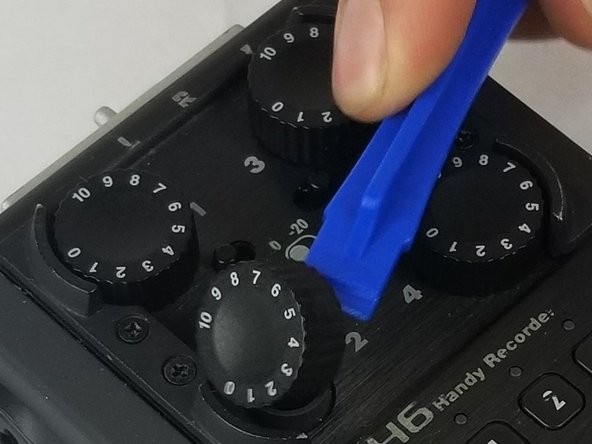

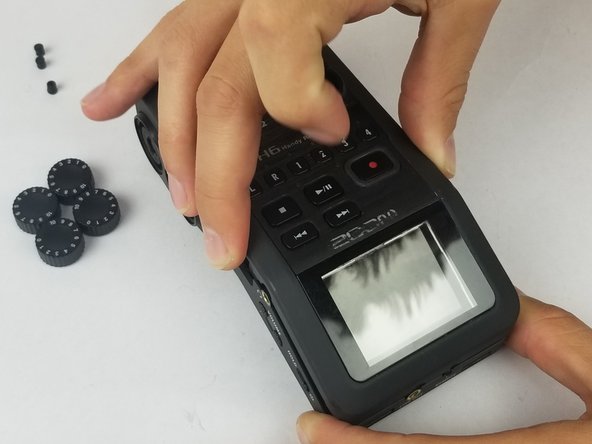

    • Place device face up and remove the four knobs using the flat end of the plastic opening tool.

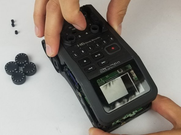

    • Carefully lift up the top of the device and gently set aside.

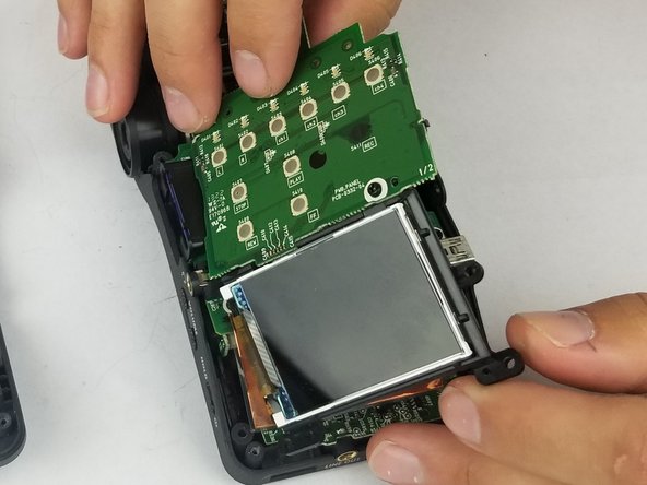

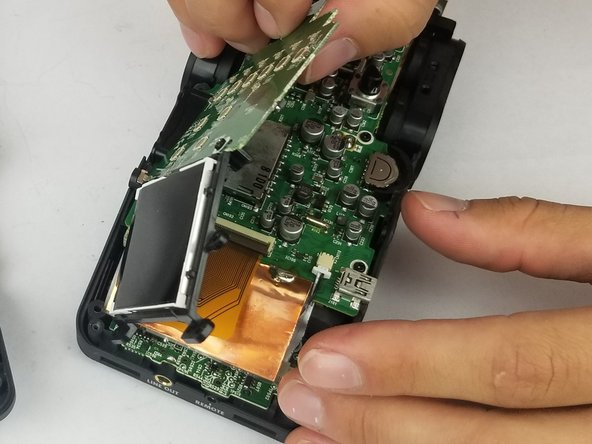

    • Unscrew three (PH #1), 7mm screws from the button board near the display and gently flip over.
  9. Zoom H6 Handy Recorder Battery Terminal Replacement: crwdns2935265:09crwdnd2935265:01crwdnd2935265:03crwdne2935265:0 Zoom H6 Handy Recorder Battery Terminal Replacement: crwdns2935265:09crwdnd2935265:02crwdnd2935265:03crwdne2935265:0 Zoom H6 Handy Recorder Battery Terminal Replacement: crwdns2935265:09crwdnd2935265:03crwdnd2935265:03crwdne2935265:0
    • Using a plastic opening tool, unlatch the clip and carefully unplug the ribbon connector from the device.
    • Set the button board aside.

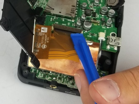

  13. Zoom H6 Handy Recorder Battery Terminal Replacement: crwdns2935265:013crwdnd2935265:01crwdnd2935265:03crwdne2935265:0 Zoom H6 Handy Recorder Battery Terminal Replacement: crwdns2935265:013crwdnd2935265:02crwdnd2935265:03crwdne2935265:0 Zoom H6 Handy Recorder Battery Terminal Replacement: crwdns2935265:013crwdnd2935265:03crwdnd2935265:03crwdne2935265:0

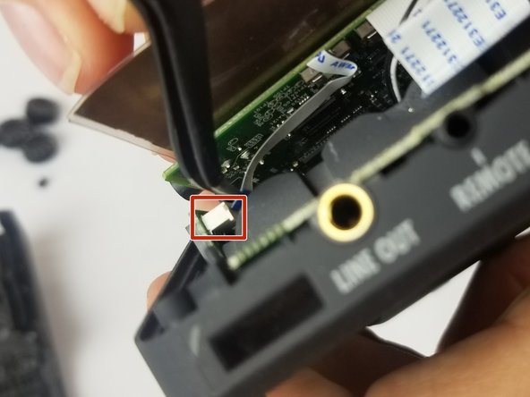

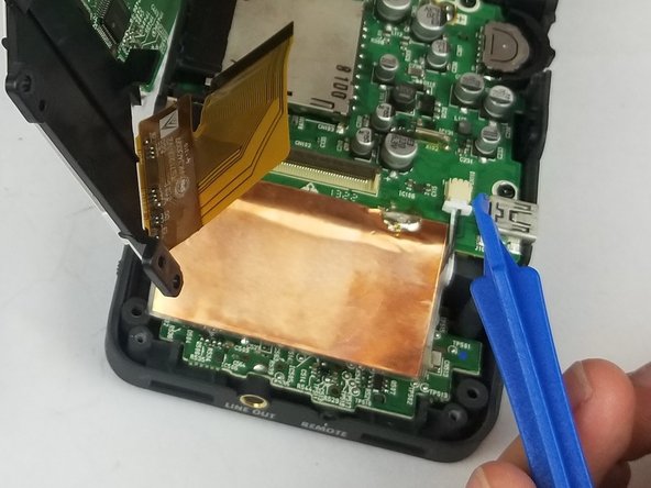

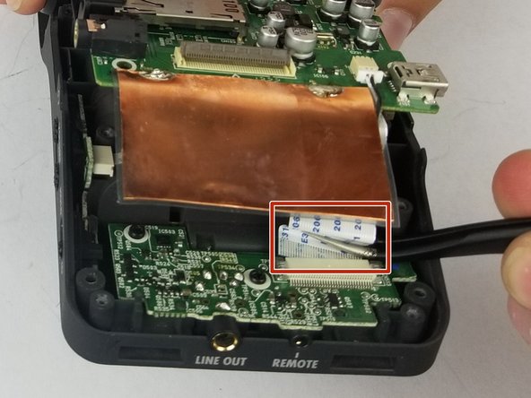

    • Gently remove three ribbon connectors from the base of the device. One is connected to the mic connector, the other two are on the top of the device next to the "LINE OUT" plug-in (directly behind the device display screen).
    • Use tweezers to remove the two ribbon connectors behind the display screen because it is difficult to remove them only using hands.
    • Avoid touching anything but the ribbon connectors with the metal tweezers.

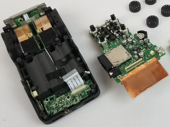

    • Gently lift off motherboard from the base of the device.

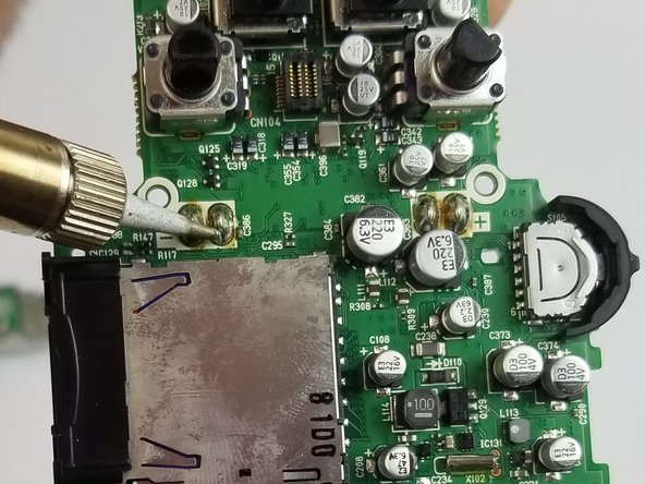

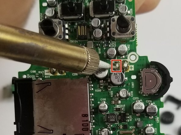

    • Taking care not to damage other components on the motherboard, use a soldering iron to undo the soldering that holds the terminals to the motherboard.
  16. Zoom H6 Handy Recorder Battery Terminal Replacement: crwdns2935265:016crwdnd2935265:01crwdnd2935265:03crwdne2935265:0 Zoom H6 Handy Recorder Battery Terminal Replacement: crwdns2935265:016crwdnd2935265:02crwdnd2935265:03crwdne2935265:0 Zoom H6 Handy Recorder Battery Terminal Replacement: crwdns2935265:016crwdnd2935265:03crwdnd2935265:03crwdne2935265:0

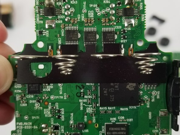

    • Flip motherboard over and remove the black tape covering the battery terminal.
    • Replace with new terminal.
    • Resolder the terminals to the motherboard.
